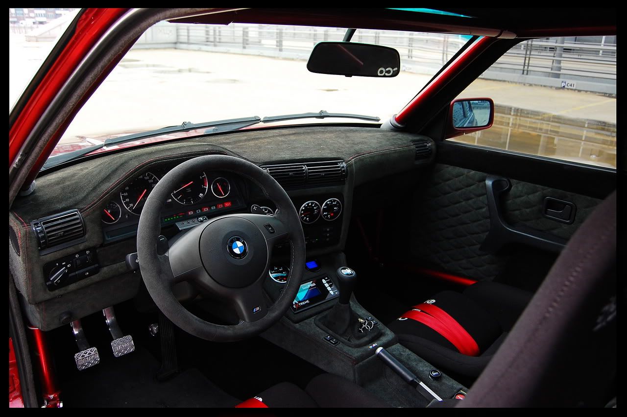

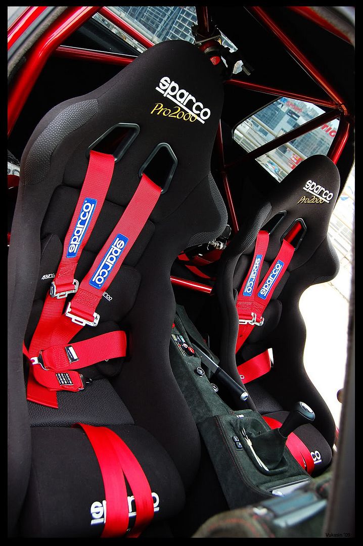

Interior
- Sparco Pro 2000 seats
- Sparco 6 point harness
- Custom made alcantara upholstery + Dynamat sound and thermal insulation

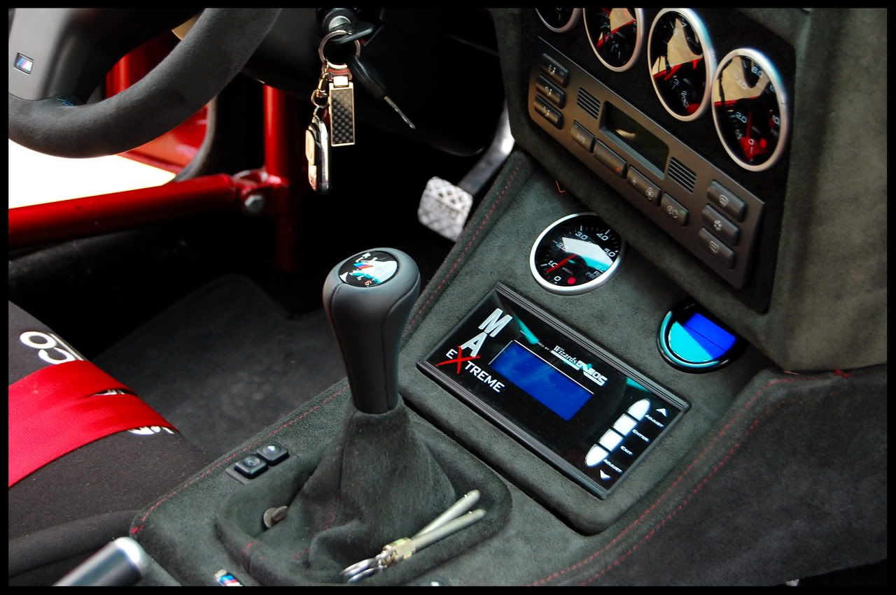

Electronics & electrics

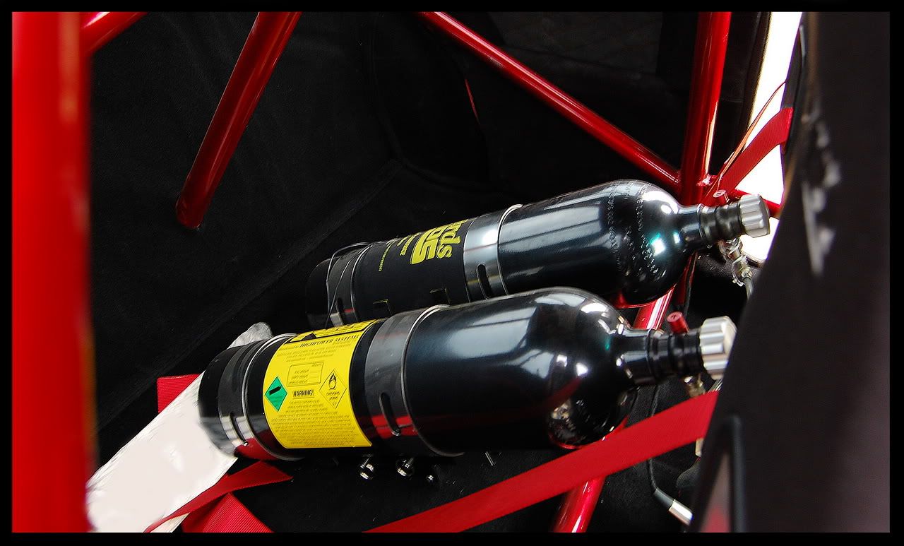

- OMP electric fire extinguisher boot/cockpit/engine
- Power kill switch
- Defi Link BF computer controlled gauges: boost, EGT, fuel pressure, oil pressure, oil temperature
- Innovate A/F gauge
- Innovate datalogger
- Intercooler cold / hot charge temperature
- Wizard of Nos nitrous controller with nitrous-based turbo antilag system
- Custom made central panel – fan, nitrous, linelock, N2O, CO2, antilag
- Custom made dashboard
- Electronic cooling fan control
- 5000k HID headlights
- Engine oil pressurizing system for cold starts
- Oil & water recirculation system after engine shutdown to prevent turbo damage
